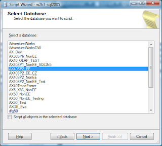

Select the proper database and check Script all objects in the database and click Next.

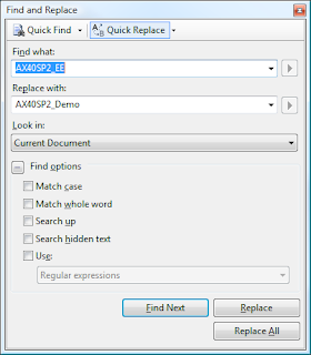

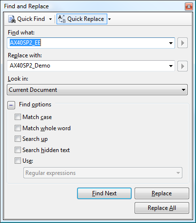

The script will be open in a new query window. Now we need to change name of the database. Press CTRL+H to open Replace window and type original database name into Find what text box and new database name into Replace with text box. Then click Replace All to use new database name through the whole script.
You may close the Find and Replace window now and press F5 to execute the script. Ignore any warnings regarding maximum key length.

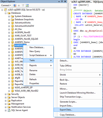

When the script finishes we have a new database with required collation. We need to transfer the data now. This can be done using Import and Export wizard. Right-click the original database and select Tasks -> Export data from the context menu to start the wizard.
