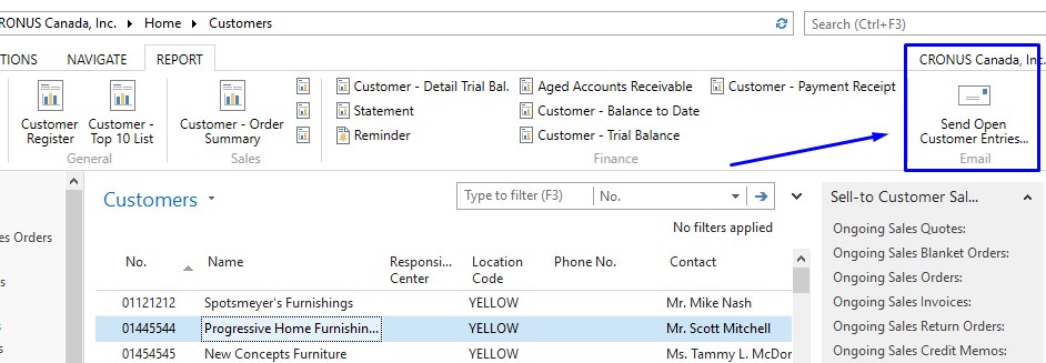

Case - My Customer requested to customize NAV for the possibility of sending Report Open Customer Entries using an action on customer page.
Let's Create a Codeunit to send email using the Pattern discussed above -

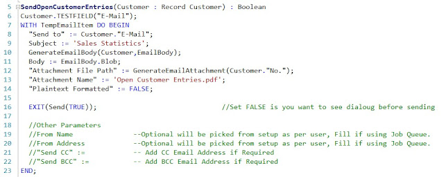

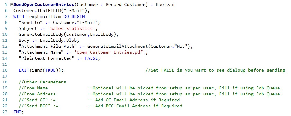

1. Create a Function which accepts Customer record as a parameter.
This function check that Email Exist on Customer or not and then generates the record in Email Item.

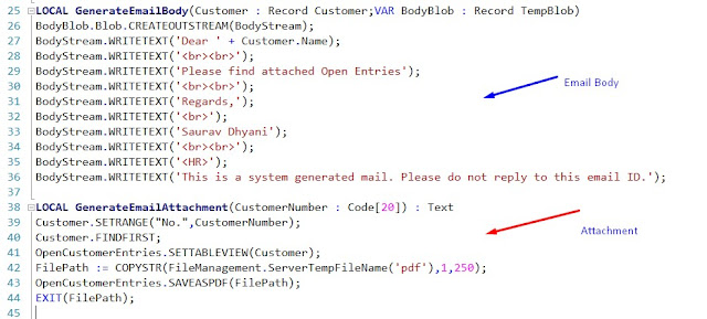

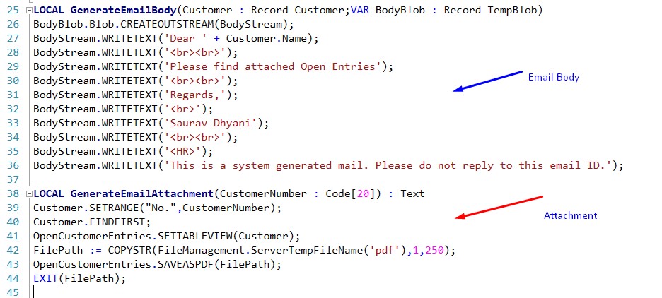

2. Create Two supported functions which be called from above function.
These functions create Email Body and Email Attachment.

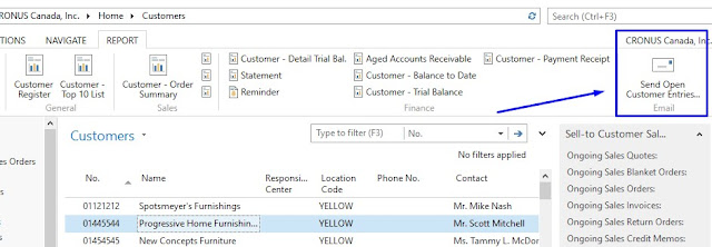

3. Let's Now add action in Customer List / Card which calls this custom codeunit function.
Now Let's Demo the code -
If all setup is correct then the system will generate an email as shown below.
