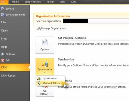

To configure Office Outlook 2010 filters,
1. Navigate to File>CRM> Synchronize dropdown.
2. After clicking the “Outlook Filters”. Users can change the filter to control what data sync into their outlook.
