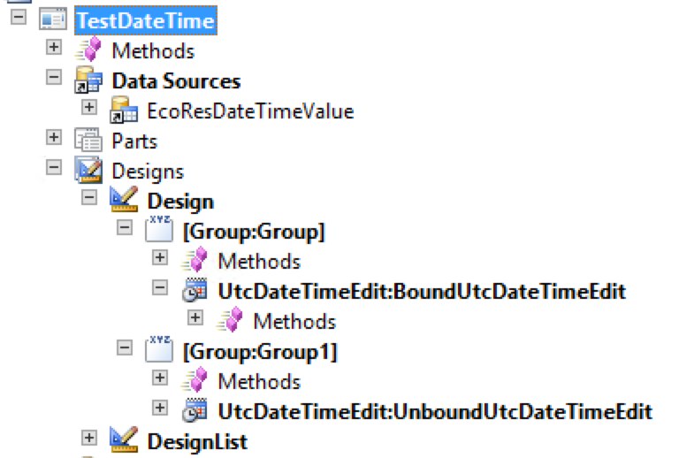

Let's create a form with 2 UtcDateTimeEdit controls:
- BoundUtcDateTimeEdit is bound to EcoResDateTimeValue.DateTimeValue table field
- UnboundUtcDateTimeEdit is unbound and is based on AttributeValueDateTime EDT.
The user time zone is set to GMT+02:00:
