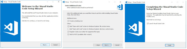

Step 2 - Download and install Visual Studio Code.
Download the latest Visual Studio Code using the link.
Install the Visual Studio Code as shown below. (Run as administrator)

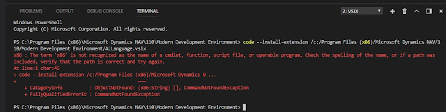

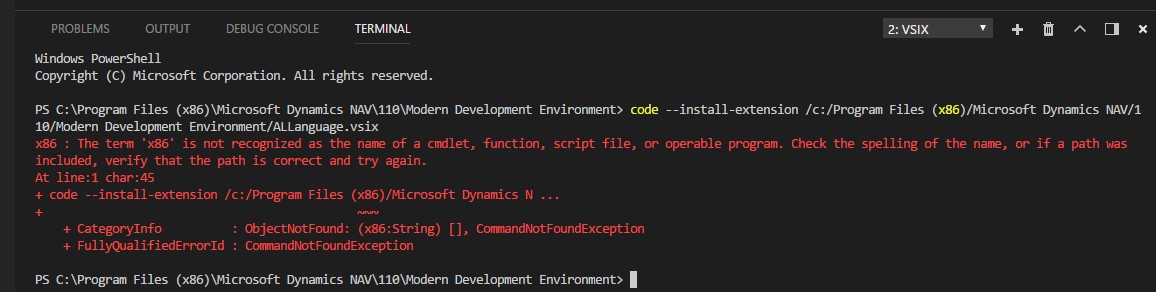

You also may run into error message, as i did during installation (shown below).
Manually write code to install the extension -> code --install-extension ALLanguage.vsix
