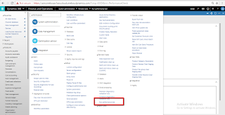

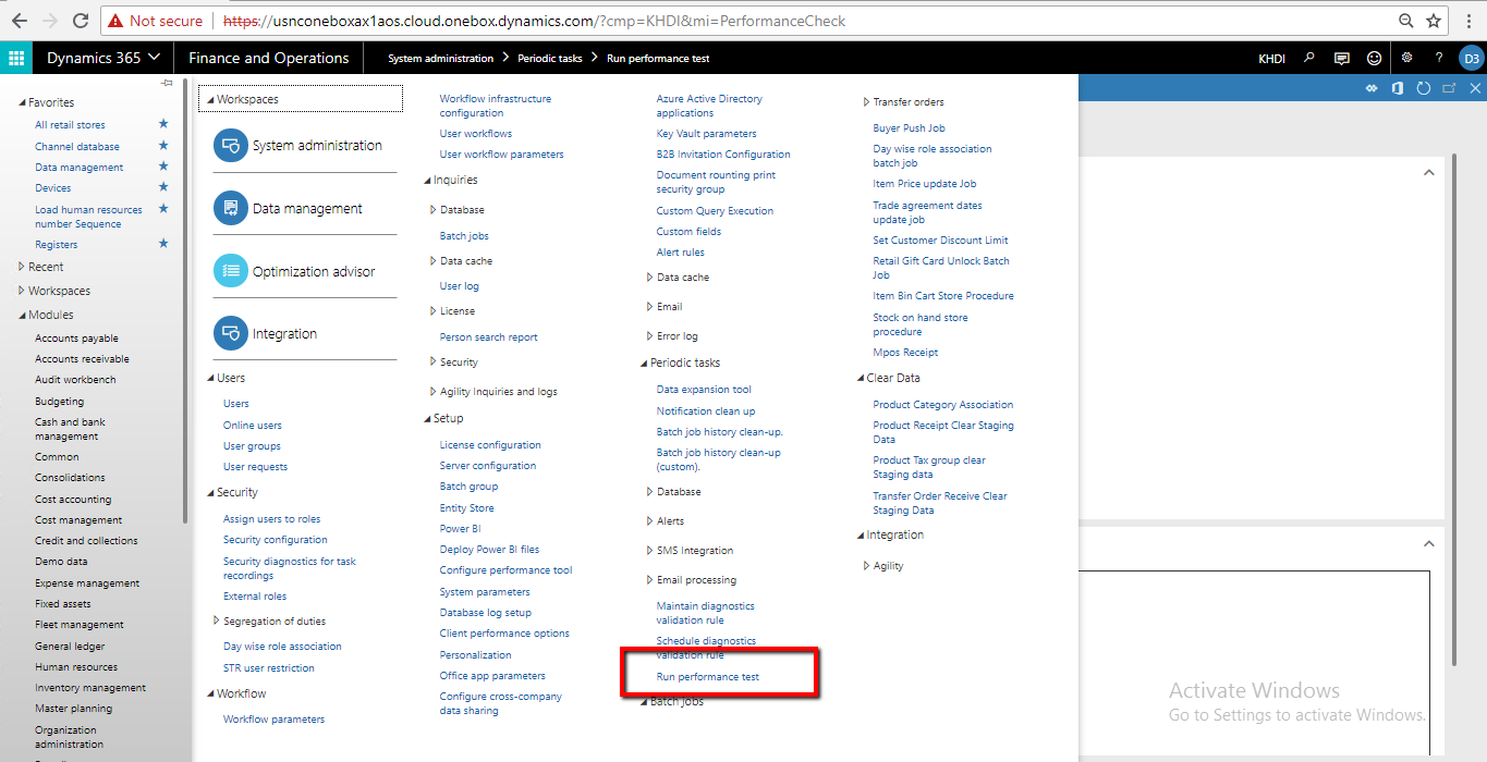

Today, I found standard feature of performance optimization in Dynamics 365 For Finance and Operations ....
Microsoft called this feature as Performance tool
You can find the navigation of this tool as below...
You will find lots of option here to optimization, Over internet I didn't find any documentation of this feature. So I am sharing some items i have explored.
