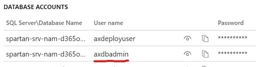

Sandbox AOS server:
From the LCS sandbox environment details page, under Database Accounts section, note the SQL Server \ Database name, password for user name axdbadmin.

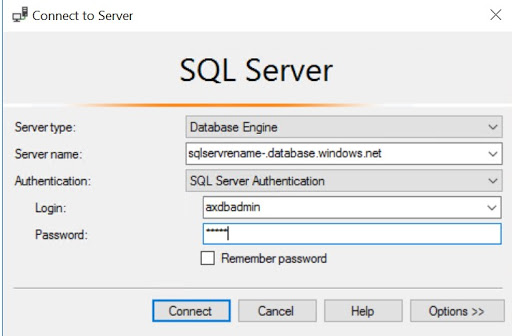

On sandbox AOS Server, open SQL Server Management Studio (SSMS) and connect to the azure sql server with sql server name, user name and password noted above.
Note: in order to complete the sql server name, suffix .database.windows.net with server name from LCS.

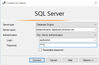

Development server:
On your development server, open SSMS and try to connect to the same azure sql server using axdbadmin creds we noted above. At this point, you should be able to connect to the sandbox Azure SQL Server database.

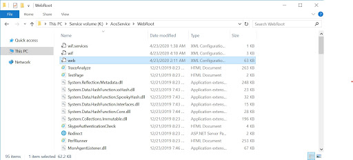

You can find web.config file on service drive, and in the AoSService\WebRoot directory. (Typically, the Services drive is drive J or K.).
Open the web.config file in Notepad or another editor, and change the following configurations:
Save the file and restart IIS or IIS Express.
