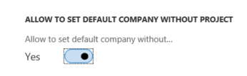

For example, our business scenario is to allow the user to select Default company without selecting a Project while creating a new Purchase requisition. (I added a new parameter to the module)
Therefore, we have to change the logic of validateCoexistenceOfProjectAndBuyingLegalEntity method, which is called inside of PurchReqTable.validateWrite().
Standard, it does not allow to have an empty Project once Default company is chosen.

        if(PurchParameters::find().PurchReqAllowCmpInfoDefWithoutProjId)
