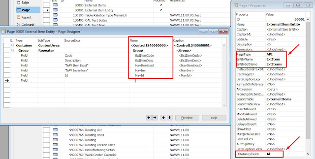

Let's create an API page that we will require to configure in API Page which has all 44 standard pages published.
1. A New Page Type is added in NAV 2018 that is API.
2. Specify EntityName and EntitySetName that will be used in URL to access by the external system.
3. Also Speicy OdataKeyField the GUID Field i.e ID as shown below.
