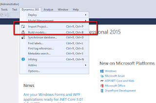

Step-6 Open Visual studio and Navigate to Dynamics 365 and click on import project.
Reference Screenshot

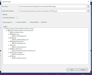

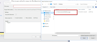

Step-7 When you click on import project, A popup will appear. provide the path of the project you want to import.
Step-8 once project imported, Visual studio show the complete elements which are part the project.

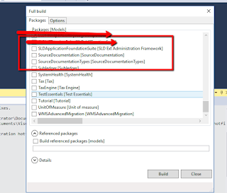

Step-9 click on Ok button, Activity will take time because it will create module and sub model if not exists on your environment and perform compile. You need to perform Database sync manually.
