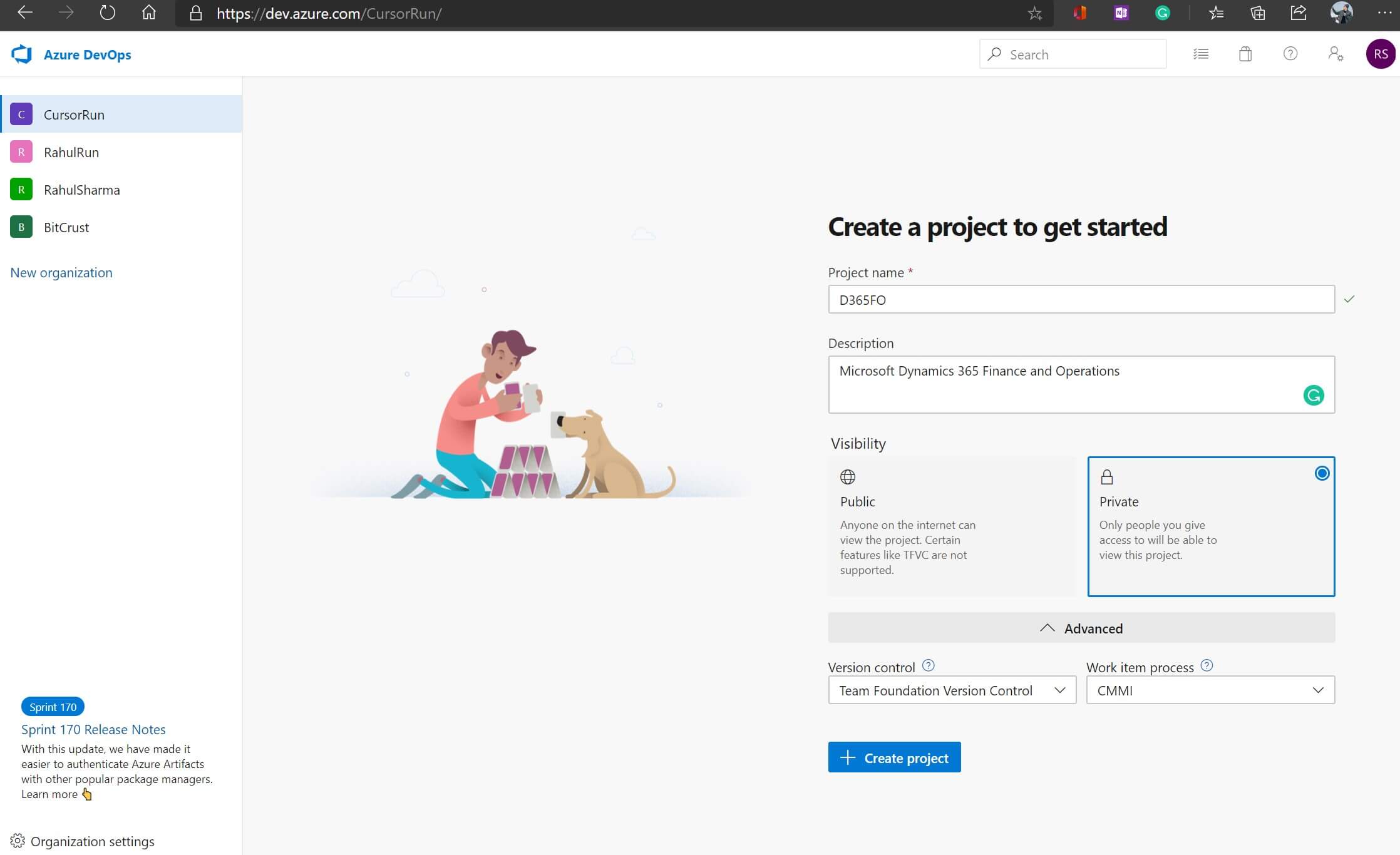

Create DevOps Project
Create a new project with the following settings. This project will hold all our work items, code, pipelines, etc
DevOps: Create Project
The main point here is to make sure we have Version Control set to Team Foundation Version Control. This is what D365FO supports.

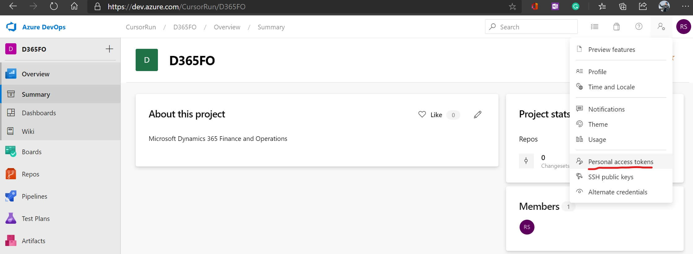

Obtain a personal access token from DevOps
Go to your DevOps organization https://dev.azure.com
DevOps: Personal Access Token

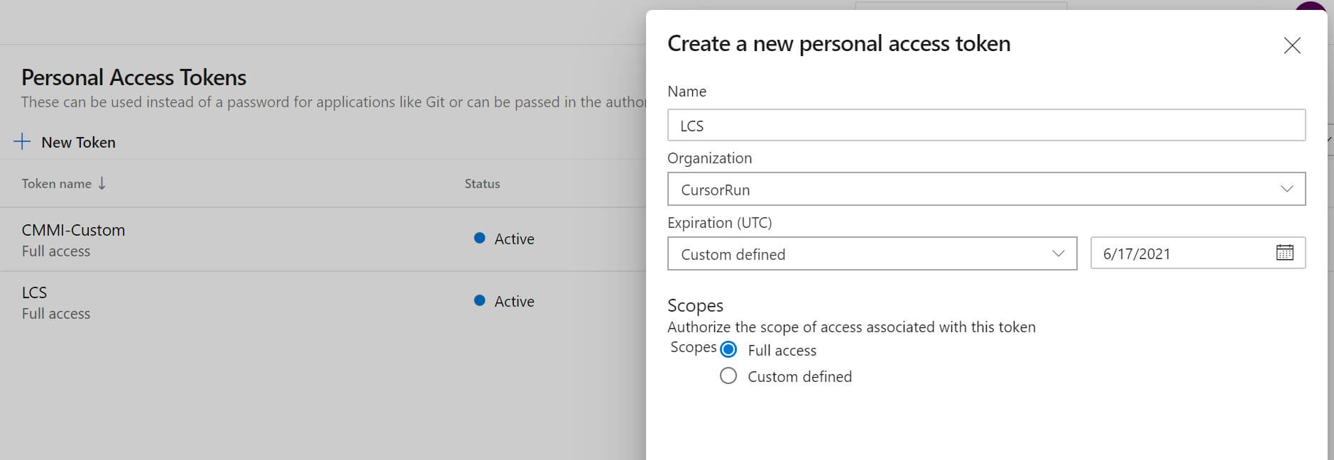

Select the token expiry period. You can select a maximum of one year. Also, give full access.

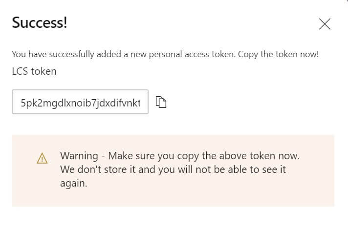

Click on the create button and copy the token value.
Do copy the token value at this point as this will disappear once the window is closed.

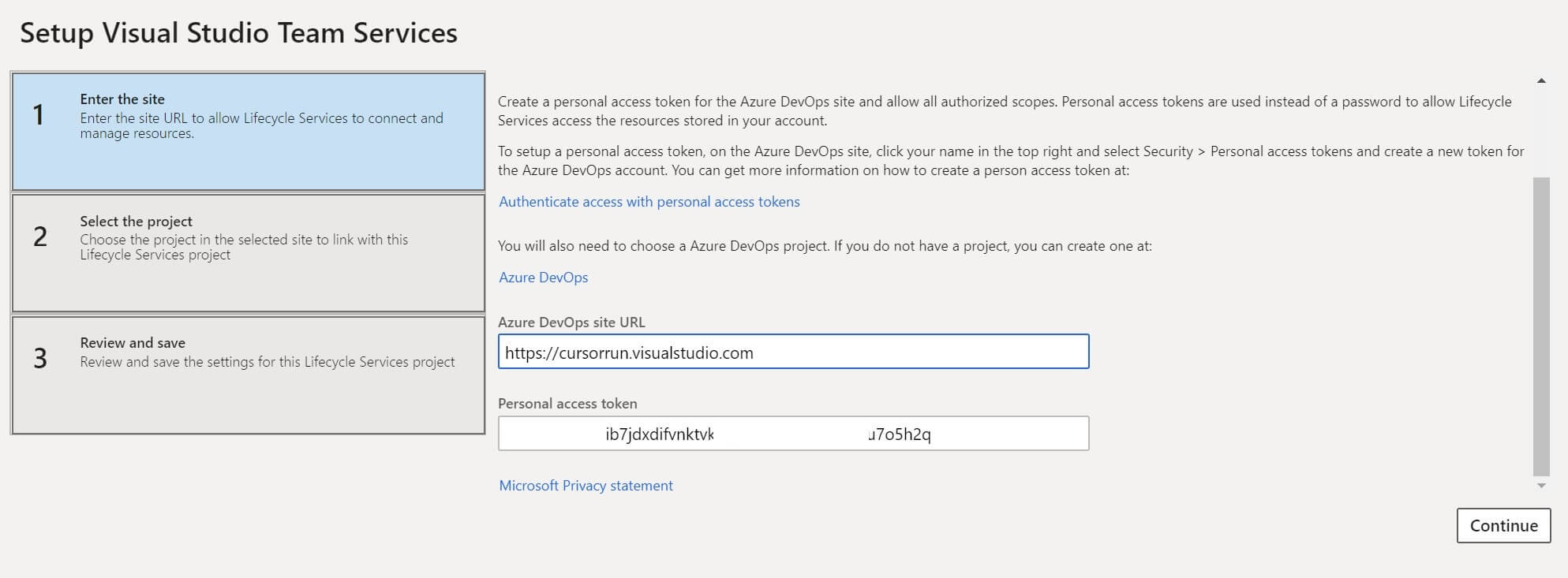

Open LCS https: project, and go to Project Settings > Visual Studio Team Services.
LCS DevOps
VSTS is now DevOps but LCS still only accepts legacy URL of the DevOps account and organization we created above. URL format is https://.visualstudio.com/
Paste the personal access token at this step and click Continue.

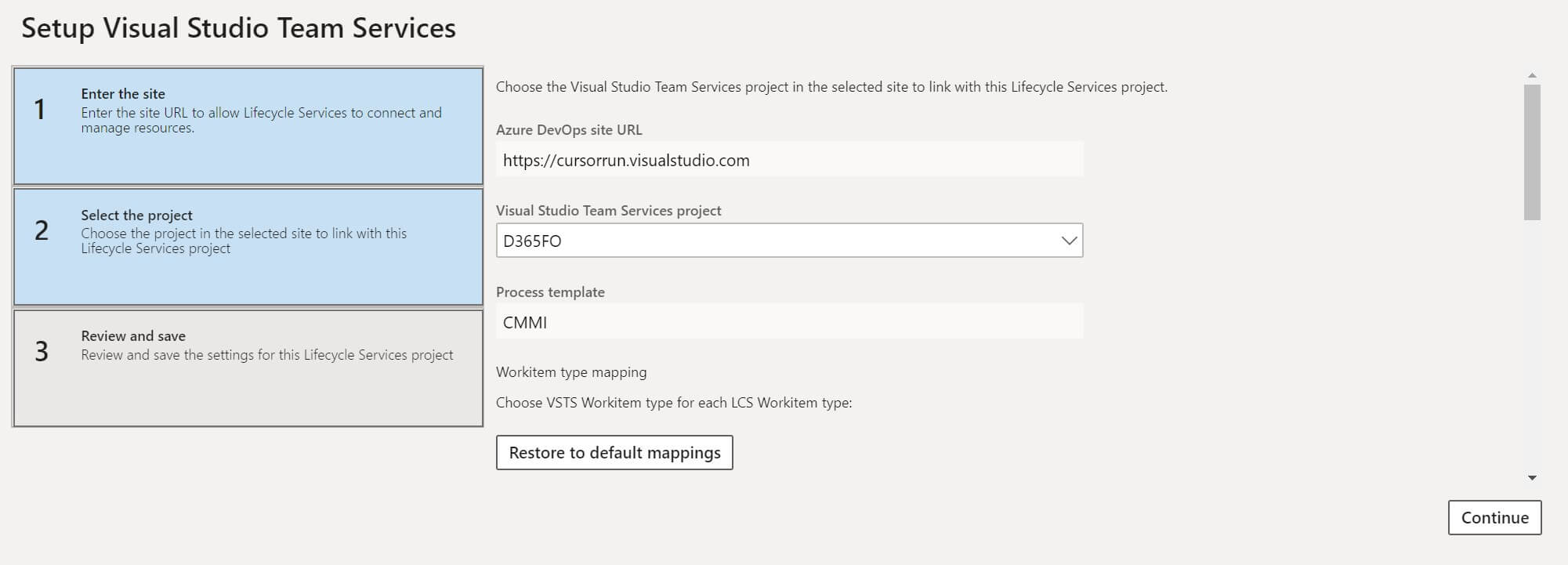

On the next screen, select the DevOps project we created.
LCS DevOps
Click Continue and review the changes we made. If everything looks fine, save the wizard and finish creating the link between LCS & DevOps.
